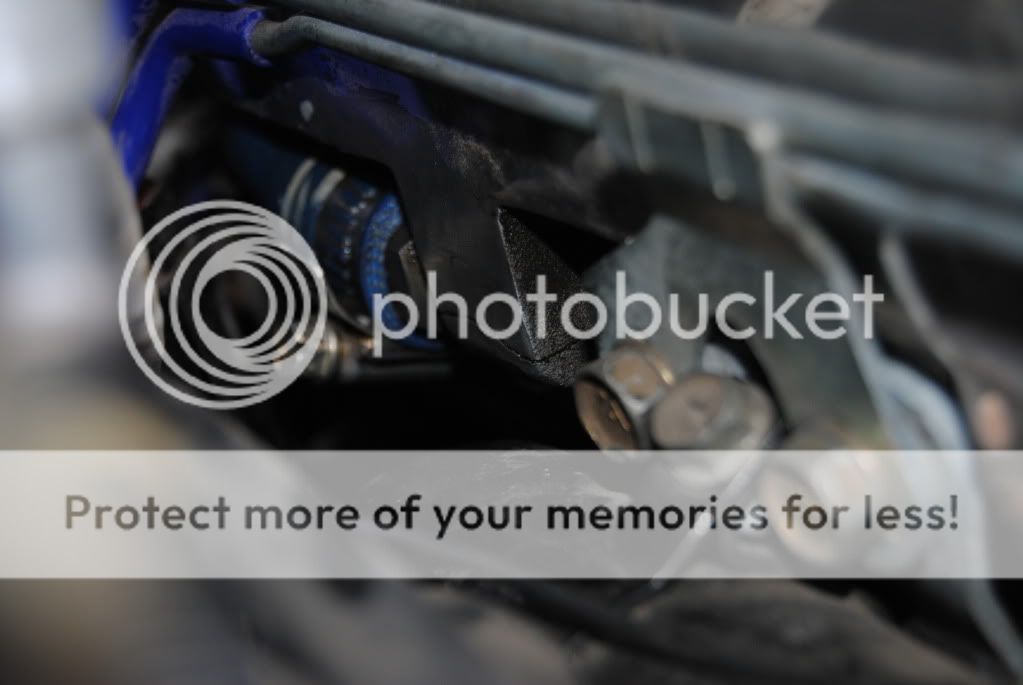

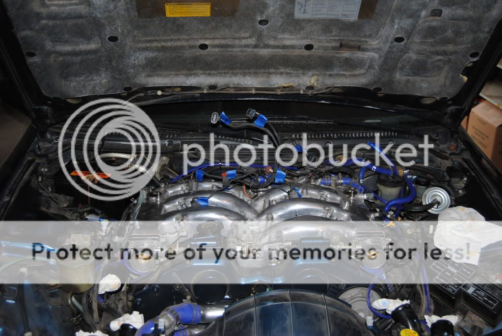

Message A few months ago, I polished my upper plenum, installed new fuel injectors, PCV valves, hoses, and other misc stuffs.
Car ran OK but was always idle hunting, so I bought a boost leak detector from Chris at boost pro, and found this nice little leak from over-tightening the PCV valve:
Well that sucked, but I work full-time and am a full-time student so a relatively quick plenum pull can take a little while to do with such little free time. Especially since I during all this, I bought my first house and didn't want to tear down the car when I could be moving again in short notice (New home for Zed!!!)

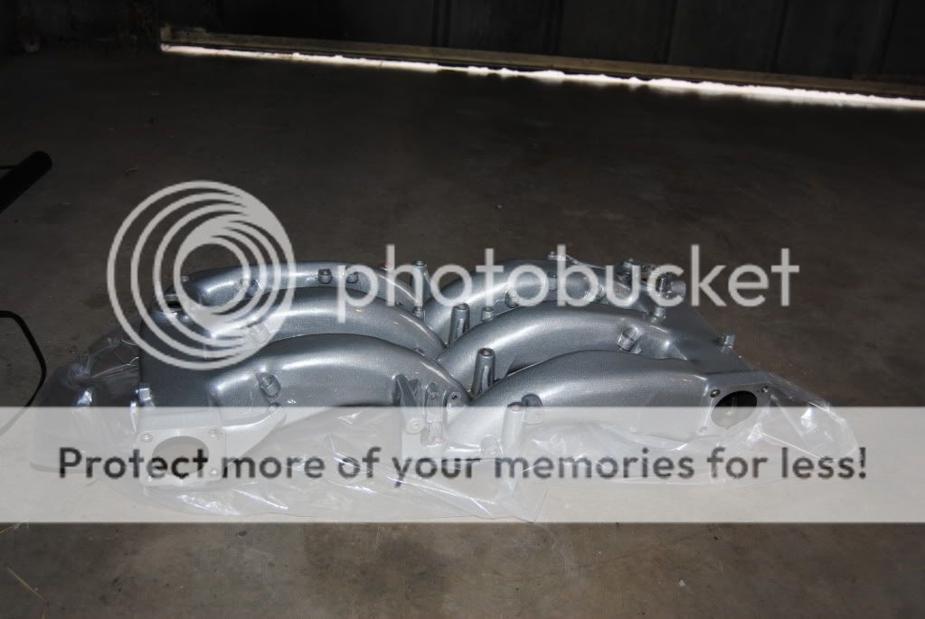

So I bought a new used plenum from John(MD) and had it powder coated metallic silver

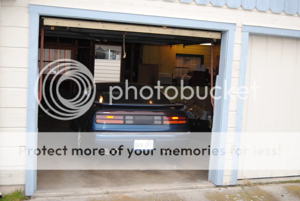

The new garage comes with parts storage to help keep me organized!

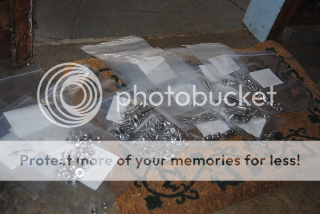

New SS hardware from Fastenal (thanks to BigTDogg for the write up)

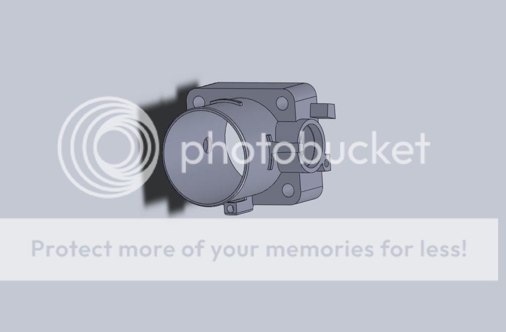

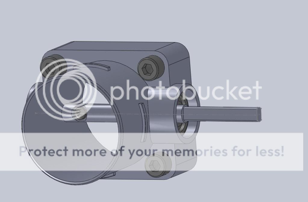

Also somewhere along the lines in school, I started an extra-ciricular project to design a new throttle body and here is what I've come up with so far:
It's been a while since I've had time to work on it, and I now the vac tube needs to be moved a little, but I think I'm pretty close to cutting my first proto-type.
